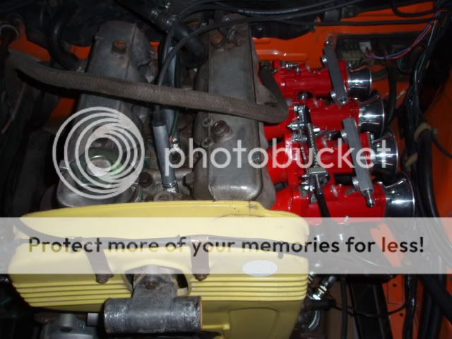

As you may or may not know in currently fitting EFI/ECU to my 131 sport.
Ive fitted the Throttle bodies to the 'Offset' manifold and i have a small problem.
Not enough room between bulkhead and fuel rail, so im looking for a 'straight' manifold.
Can anyone help?

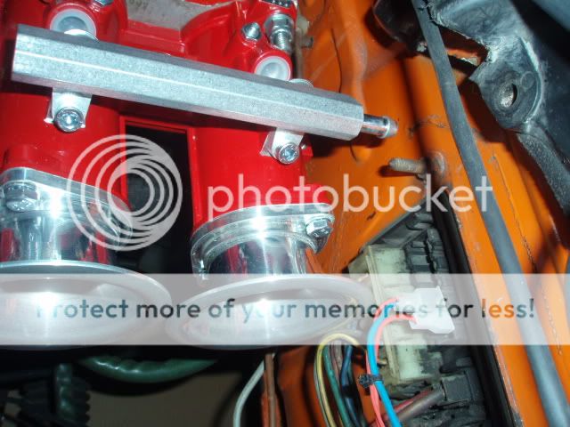

Can't you turn the fuel rail input over to the other side? Seems to be enough room especially if you use a 90 degree fitting. Aren't you supposed to have a 'common rail' feed on this system as on twin carbs? (i.e. connect the fuel feeds together).

« Reply #2 on: November 07, 2009, 08:33:16 PM »
Parrish ,  looks very good indeed !!!
RE manifold , The tilt was to avoid the  block mounted distributor , 0of you put one in the head you will be able to put either a straight or a forward tilt manifold which will give you plenty of space.

« Reply #3 on: November 07, 2009, 08:52:09 PM »
Thotos,
Yes its a common fuel rail that runs a return to the tank hence the connections at both ends, one will be an inlet the other a retun to the swirl pot,  its shown mocked up in the photo without the middle rail.

« Reply #4 on: November 07, 2009, 09:00:27 PM »
So why not simply change the fitting near the bulkhead with a 90 degree one for the return pipe?

« Reply #6 on: November 08, 2009, 07:39:15 AM »
Theo,
the fitting at the end of the fuel line appears to be non removable, i am trying to get hold of another fuel rail to see if it can be done, but even then clearence is minimal. However i may have to see what i can do along those lines.

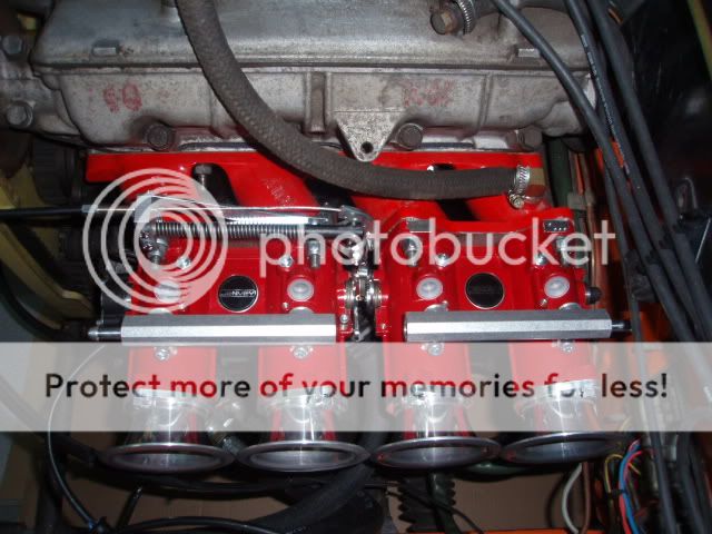

« Reply #12 on: November 08, 2009, 01:46:26 PM »
djape,
no its definetly different, imagine the manifold on the engine, then look at the position of the top carb mounting points in my photo, they need to be wide apart, this manifold would put the top carb mountings close together?
