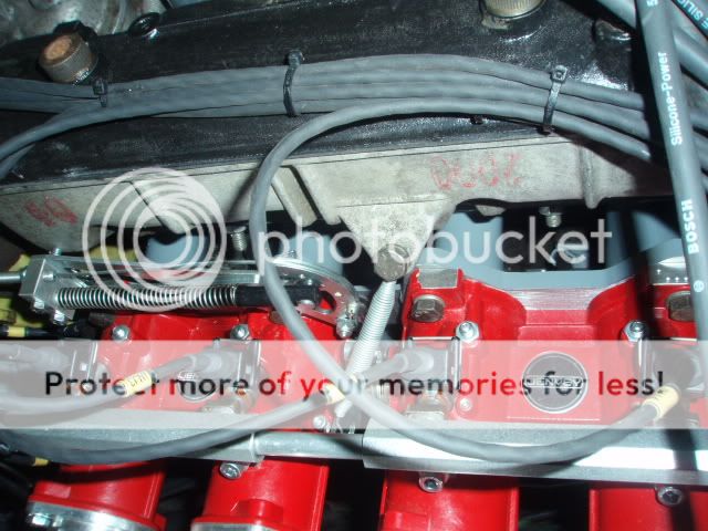

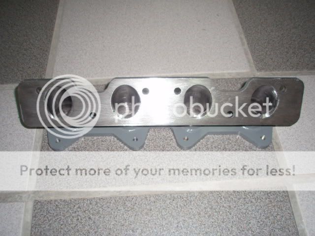

Ive been waiting for some time for a custom inlet manifold to arrive from Alinson Austomotive in the states.
Those of you that have been following my postings will know ive fitted and ECU/EFI Omex unit with Jenvey throttle bodies.
The inlet manifold i had was a GC off set one, this gave me clearance problems between the last TB and the bulkhead and i had no space for a return hi pressure fuel line and or an air box.
I contacted Alinson Automotive and they have manufactured a new inlet manifold to my design, the new manifold sets the TB's at approx 22 degrees to the horizontal and brings the TB's 35-40 mm further forward.
The manifold and a Hi-Torque starter that i ordered have arrived and been fitted, see photos below.

« Reply #2 on: July 05, 2010, 04:35:09 PM »
Nice work on the manifold!
How is the starter working? Looks too small:)

Time will tell with the Hi-Torque starter, ive only just fitted it and used it half a dozen times only, spins OK.

Is the motor location of the starter able to be moved to the bottom rather than at the top? I'll probably have clearance issues between my starter and supercharger and thought one of these starters may solve the issue.

Starter is as delivered, cannot be changed due to the alignment of the three locating holes, what you see on the above photo is how it fits.
The cost $225 plus shipping     www.allisonautomotive.com

Have you gone for his distributor less ignition system also ? as from what i can make out from the picture i think i cant see the block mounted or cam mounted dizzy.?
« Reply #10 on: July 14, 2010, 01:15:32 PM »
Yes i fitted an OMEX 600.
All parts available direct from Omex or through NMS (Nortampton Motor Sport) 'Troy'.
I didint fit the Alison Automotive distrbuitor less system unit as the OMEX 600 is controlling both ignition and fuelling.
