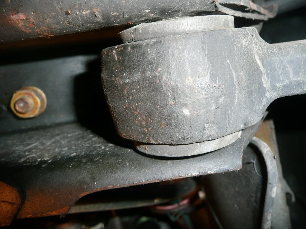

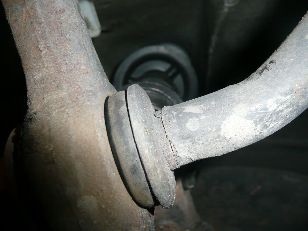

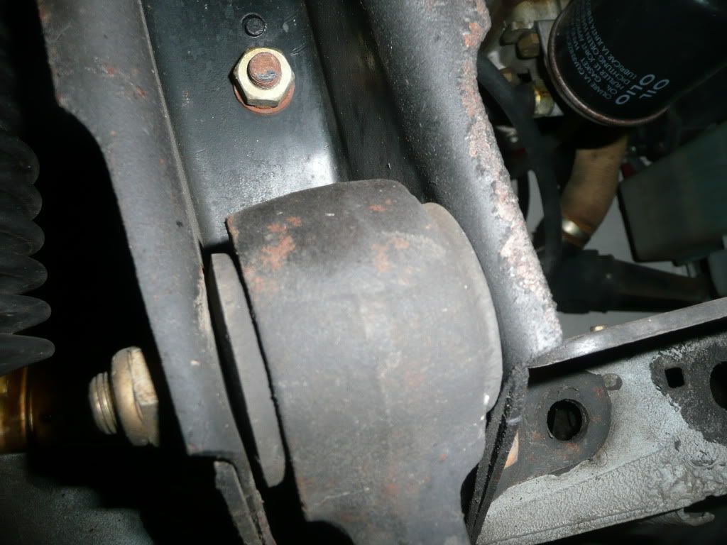

« Reply #13 on: September 28, 2010, 06:31:33 PM »
Thanks for all the helpful suggestions guys - I'd like to have all the necessary parts before getting the job done and I like the idea of some preventative maintenance at the same time especially with products that come recommended such as Yagmur's parts.
Mike - Can you explain what a top bearing is please?
I've crawled around the car tonight and taken the following pics in the hope that whatever is causing the problem might be obvious to the seasoned mechanics out there.
Anti-roll bar bushings...
TCAs
Ball joints..
Rear bushings..
Is this all of them and can anyone spot any worn parts..? Thanks... Maybe I should take pictures from a different angle..? Smiley

« Reply #14 on: September 28, 2010, 06:39:25 PM »
Top bearing can be parts numbered 2, 3 and 4 rolled up into one piece, or if seperate (depends on manufacturer), just item 3.
Photos will tell us nothing about the steering rack internals condition either Kevin.....
It's now time for a trip to a trusted garage before the next long journey.
