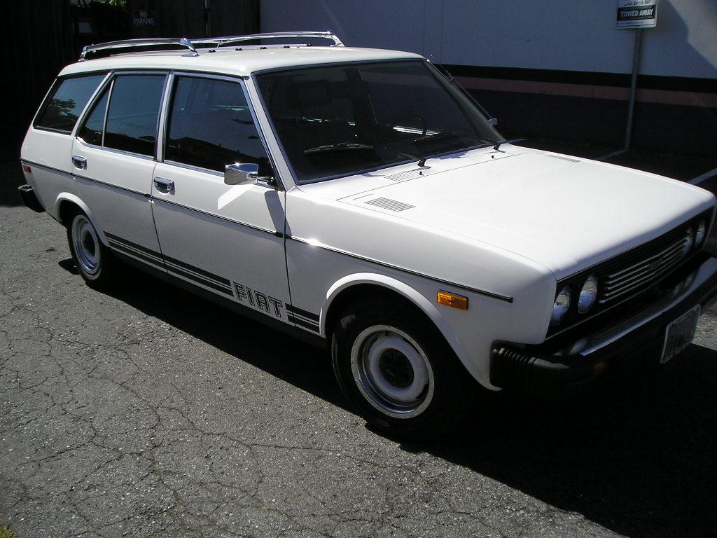

http://2.bp.blogspot.com/_zp5hU5oekAI/S-RD-gqlkQI/AAAAAAAADVQ/F_oWat_LypM/s1600/1976FIAT1311.jpg
