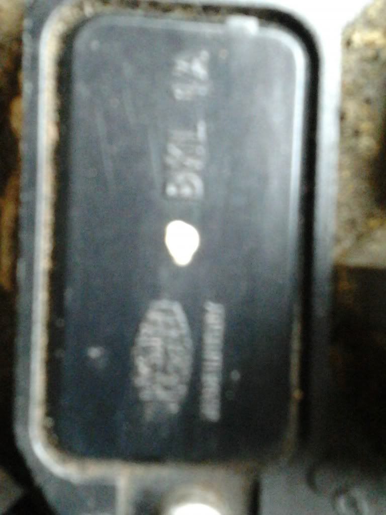

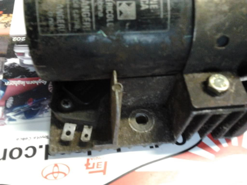

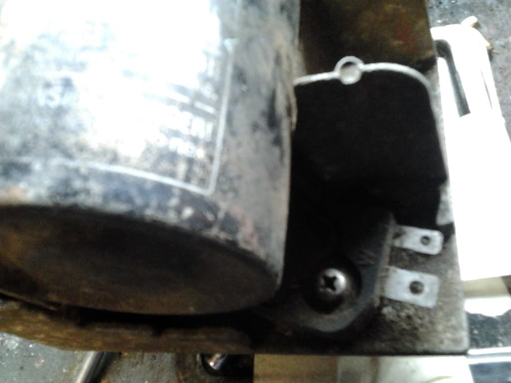

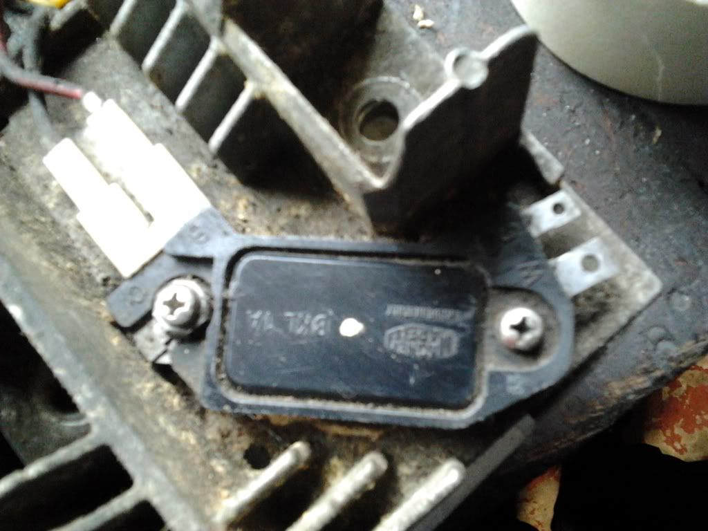

I need to find one of these for my Super...but I'm not sure exactly what it is called or from where I can find one.....any thoughts please? It's branded Magneti Marelli. Thanks.

That's not a capacitor. It's the electronic ignition module. Are you sure it's gone wrong? Car wouldn't work at all if that's gone wrong. They don't often go wrong but the wire that goes from there to the distributor always go wrong.

But the ignition modules rarely go wrong and I wouldn't change it as "preventative maintenance". If you do, then you should also replace the coil as it's more likely to go wrong. In fact I'm not sure if the ignition module is available on its own or if you'll have to buy the complete unit of module, heatsink and coil. Ricambio would probably be your best bet for getting one of these.
