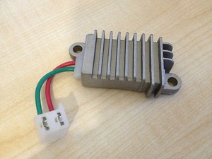

The Magneti Marelli regulator will probably look like this:
But it won't be your problem, the problem will be inside the alternator.

The silver unit in the previous photos  with the green & red cable is the regulator not the rectifier .The only problem is that you have to move the generator to install it.
