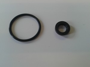

There must be an oil seal on the shaft somewhere. Something like this?
http://www.ebay.co.uk/itm/FIAT-UNO-TURBO-1400CC-DISTRIBUTOR-OIL-SEAL-/331040553141?pt=UK_CarsParts_Vehicles_CarParts_SM&hash=item4d138df8b5
I'll come round at the weekend if you like and I'm sure we'll be able to do something with it.....

I need your assistance in finding any supplier or repair workshop for Magneti Marelli distributors. In particular I'm after an internal oil seal (looks a bit like a valve stem oil seal only bigger) which sits below the bearing in a Marelli S144P cam drive distributor.
I have found a supplier in Virginia, USA (International Automotive) but they haven't yet confirmed stock. I'd appreciate it if someone had a European contact for such items, better still a UK one. Grin
Thanks guys.

If you know the inside and outside diameter sizes you can get a seal from Simply Bearings (http://simplybearings.co.uk/shop/Seals-Viton+Rubber/c19_4462/index.html). They?ve supplied me with all kinds of seals for the Gamma engine so shouldn?t have a problem supplying the one you want. If you can go for the read Viton rubber seal as they are much better quality than the black ones and suitable for modern oils.

Euroautoricambi in Australia have them on ebay!
http://www.ebay.com/itm/FIAT-124-CC-SPIDER-131-LANCIA-DISTRIBUTOR-OIL-SEAL-/350478172047
Their "Expedited Int'l Shipping" might get it to the UK in time.
Also probably worth contacting DTR European Sports Cars (http://www.dtrsports.com/ -Tel 020 8645 5050) as they specialise in the 124 Spider and may have the seals in stock.

DTR don't stock them, they told me Middle Barton Garage, so I have spoken to Tony C-M and he's going to check the part numbers and get back to me.
If all else fails I can buy the Australian one and hope it arrives in time to be fitted before we leave.
I've checked SpiderPoint and they don't appear to sell the seal on it's own but rather in a dizzy overhaul kit for the Princely sum of 165 Euros plus shipping!!! Shocked
« Reply #44 on: May 13, 2014, 02:52:24 PM »
Australian seal purchased - fingers crossed  Smiley
Unfortunately International Auto Parts in Virginia USA are out of stock of the seal until the end of the month  Cry
I have sent SpiderPoint an enquiry through their website so we'll see if they're able to provide the seal on it's own.
