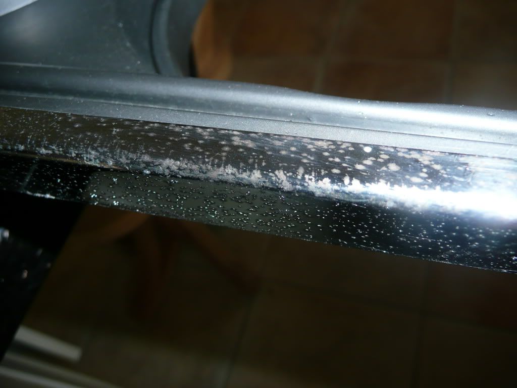

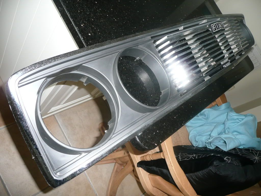

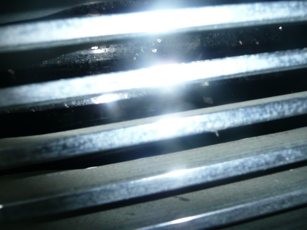

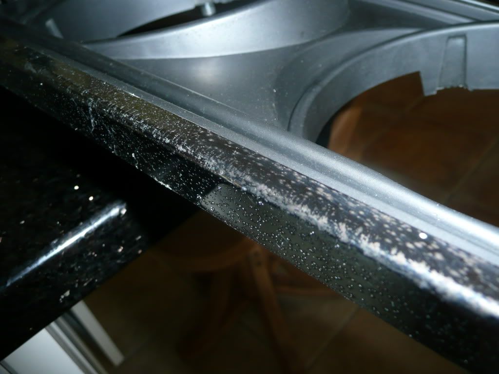

I have a new Fiat 132 grill which has deteriorated in storage. The plastic chrome surfaces have spots of imperfections all over and I'm wondering if it is possible to remove these without damaging the surface?  Huh

What looks to have happened on my grill is that the imperfections have erupted through the clear finish meaning that any abrasive agent may just smooth the feel of the article rather than remove the cosmetic flaws. However if you reccommend it, I'll give it a go. Cheers.  Wink

Sorry Kev you cant do anything to make it better, my celicas tailight surrounds were pitted also & i got a seriously expensive price to get them rechromed so they were rubbed down & painted with "rage black chrome" paint & they look great, your chrome will keep blistering, i suggest a visit to a good painter.

Hi djape1977 i also tried that so was asking a painter friend yesterday & he suggested getting the chrome bits soda blasted & the bits that were chromed painted silver & laquered,
what you suggested only works for a about a year & then it blisters again, my celica bits are painted a rew years now & are still perfect, it would cost about ?150 to get the grill done.
