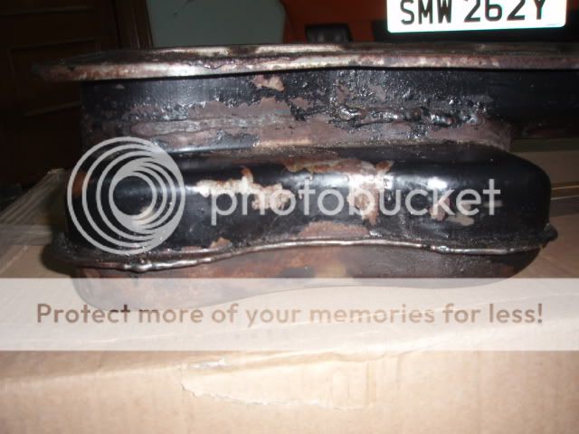

« Reply #3 on: February 11, 2012, 04:33:37 AM »

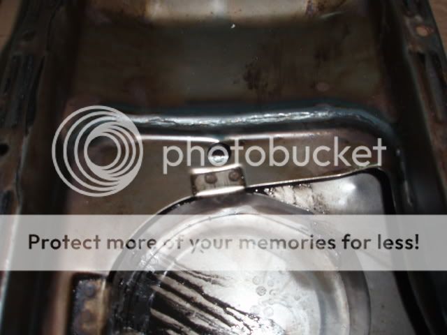

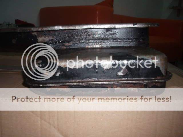

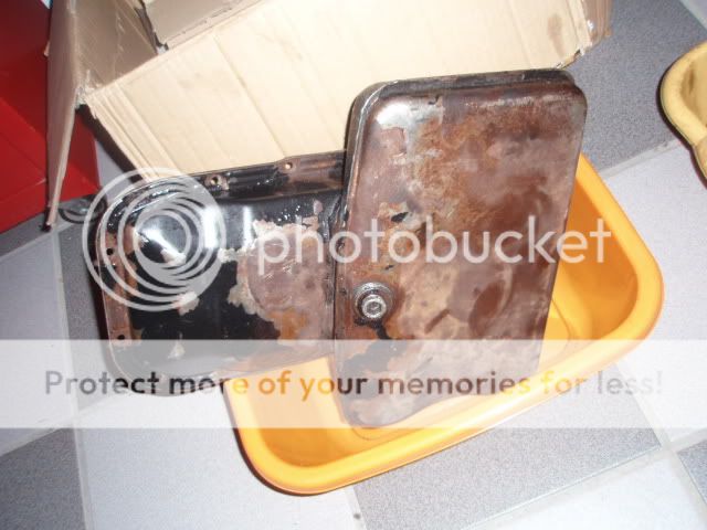

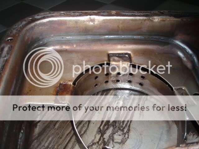

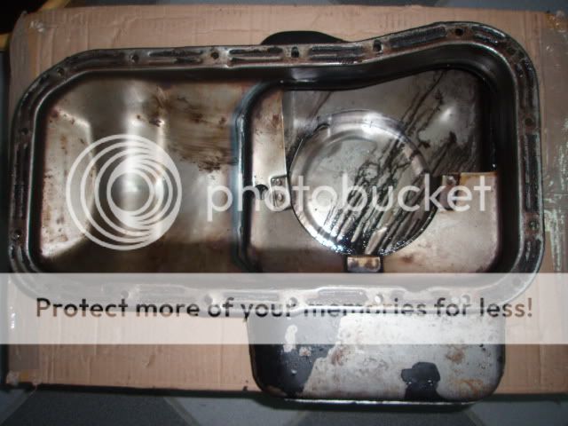

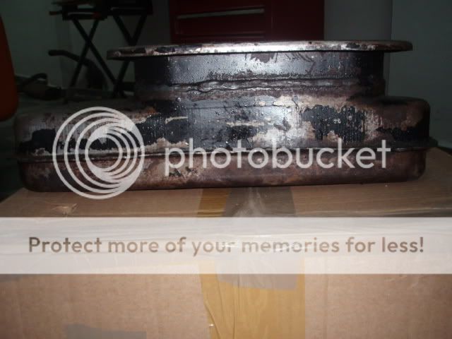

If its practicality your after, make one from your 131 sump.
Someone had fabricated this sump before i got my hands on it.
Seems straight forward.
Look and you can see the MIG welding made during alteration.
royjb
Posts: 5
« Reply #4 on: February 11, 2012, 09:16:17 AM »
Looks simple enough.  How about clearance with your oil filter?

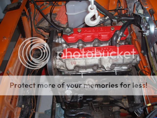

« Reply #5 on: February 12, 2012, 02:26:14 AM »
Clearance is fine, the short side of the sump if you look closely has a curved recess, dont know where the bottom half came from but it looks designed for the job.
Heres a couple of old photos of the sump on the car.

« Reply #6 on: February 12, 2012, 09:30:03 AM »
After really studying your sump it appears that towards the rear it has an indentation for steering rack or something and it looks like it could be deeper where the oil pump pick up is.  I have a couple of spare sumps so I will get them out and see how I can modify one
