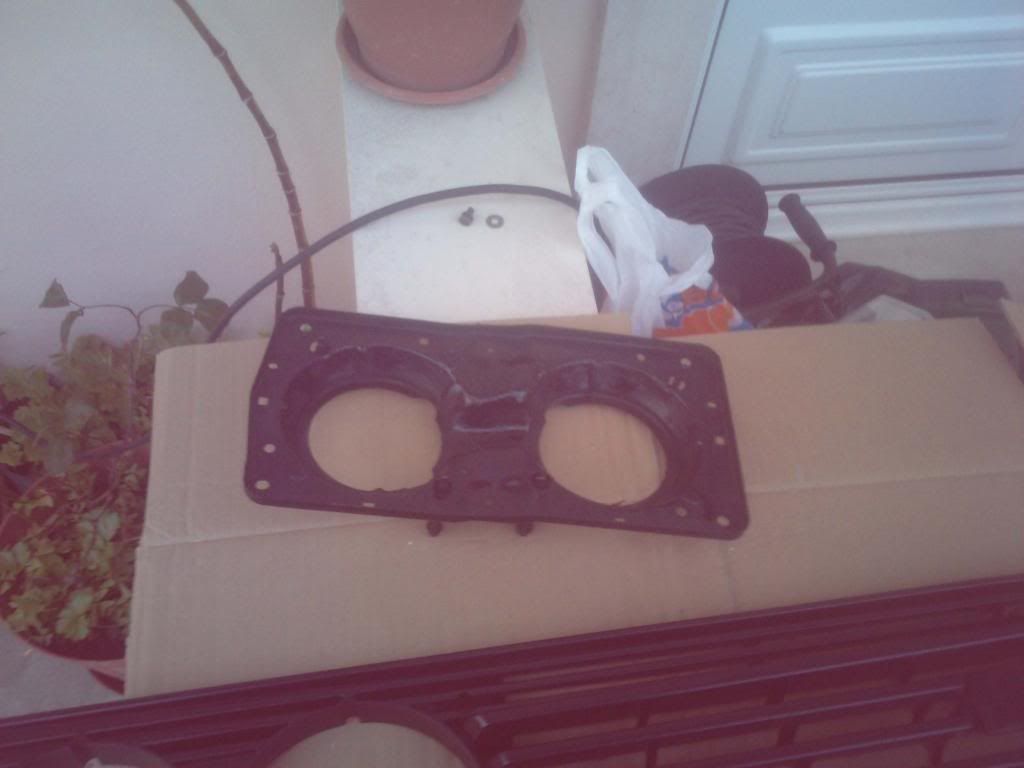

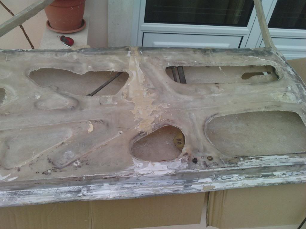

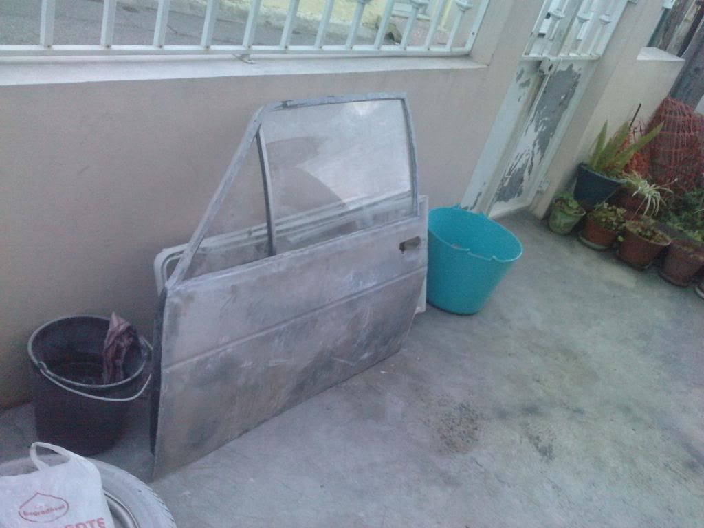

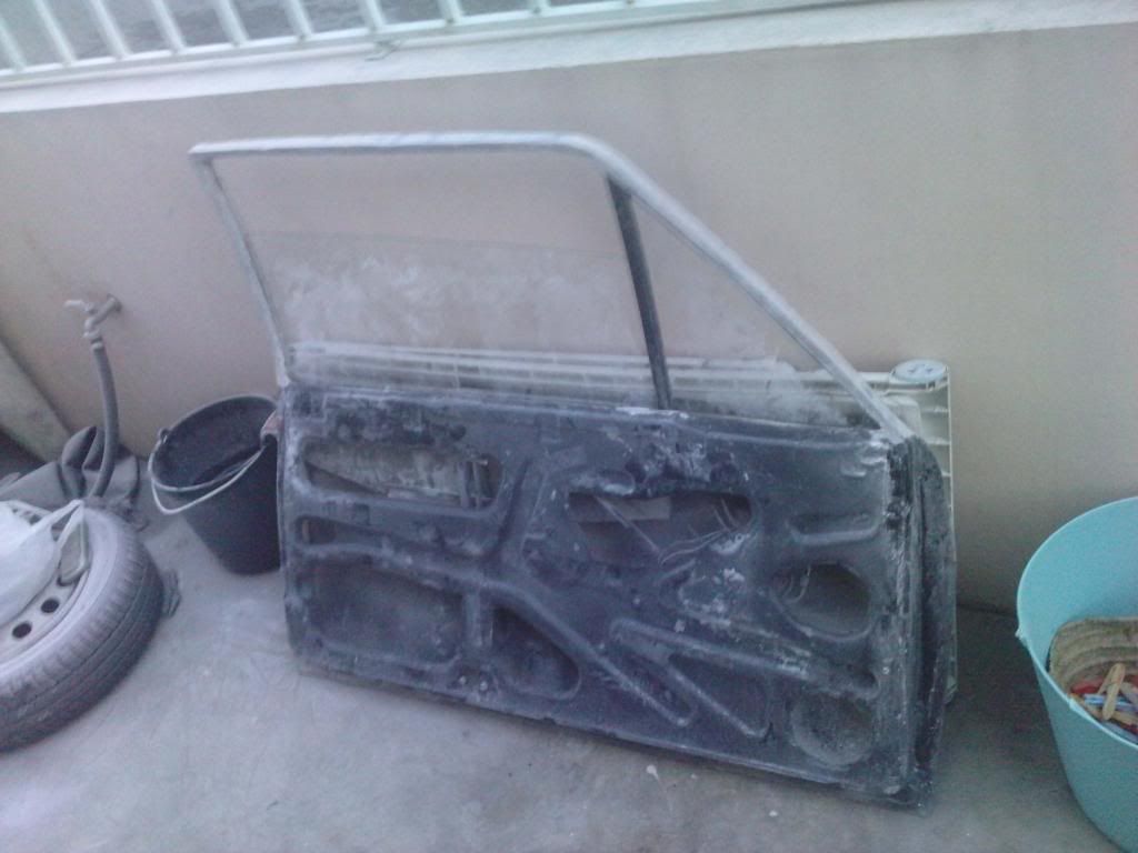

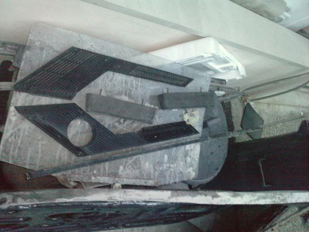

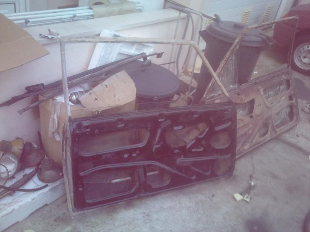

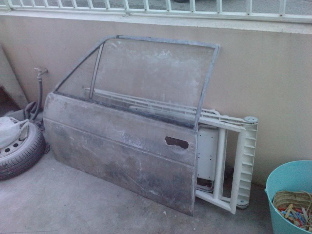

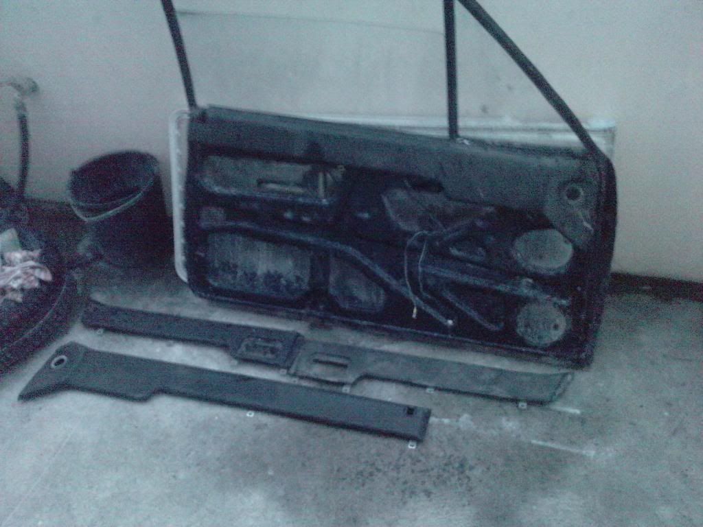

But as I just can't stop, I started grouping material for the later on Abarth look... And here's a few parts together....
I was planning to use this for the window elevator... But the position of the handle would be worst than in the stratos as J. Clarkson said in the Lancia episode of Top Gear.... So tomorrow I'll look for a pair of electric elevators to try to sort that one out:
fibre door
doors small bits and rear lights
The problem with the lights relays is also solved finnaly Smiley

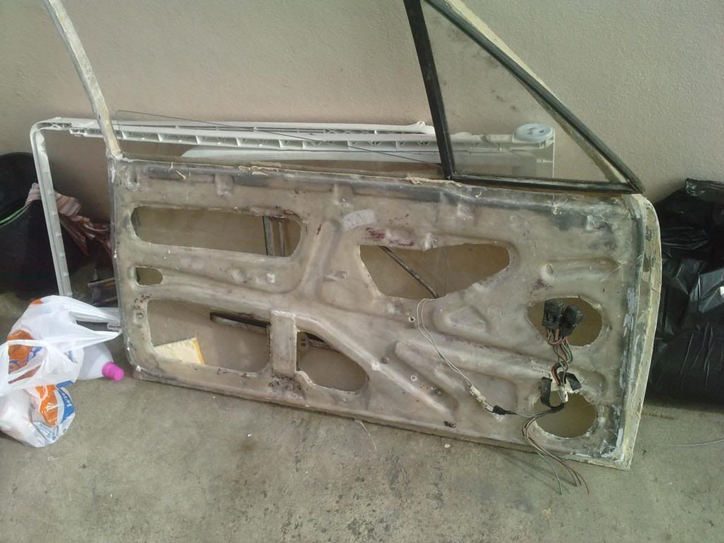

Update, the electric elevators are fitted in the doors Smiley I'm happy with the results Smiley

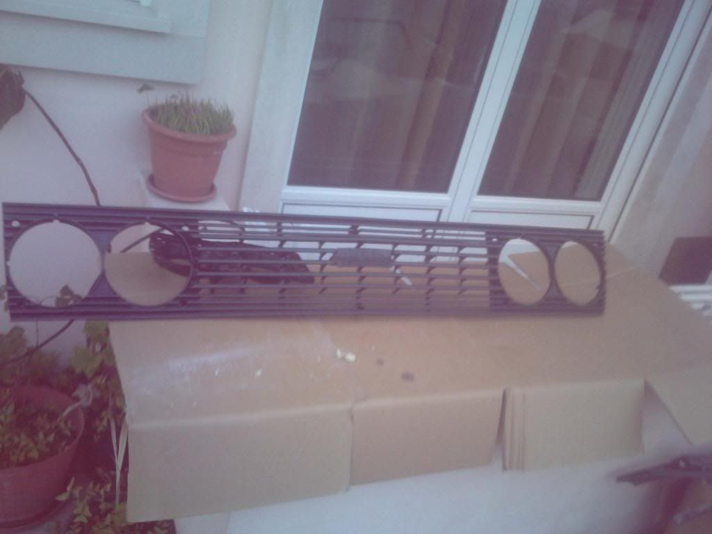

Resprayed the front grille and a headlight support ( Got to find the other Sad )

Triangles are on place, windows running in their place so all I have to do is create a little support to center the window in the elevator Smiley Next step is applying the jerrycan in the rear passenger seat and drive the car to the mot. Then I car start with the big steps.... Let's say that this is a warm up Wink
