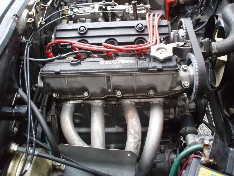

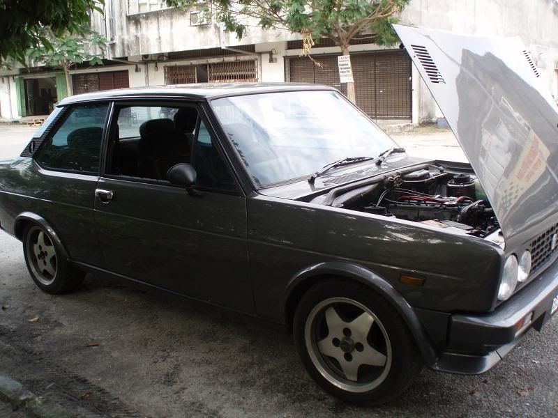

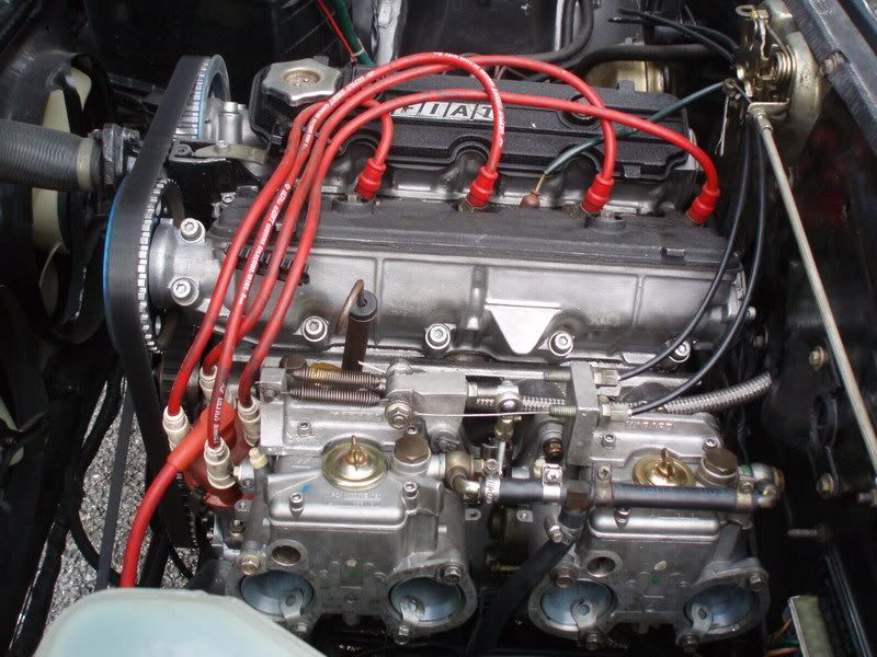

couple of shots.....any comments apart from the obvious missing aircleaner etc?..i notice most fixings changed to allen heads....

« Reply #6 on: February 01, 2008, 02:35:58 PM »
Looks great!  Shocked
The radiator is non-standard with two cooling fans fitted but I suppose that's needed in Malaysia. Or was that standard factory setup in hot countries?
Interesting dipstick modification too. I suggest the first time you change the oil you measure the amount going into the engine and then make sure the dipstick marks are correct.
The brake fluid reservoir is non standard so I suppose the master cylinder is a non-Fiat item. Maybe the brakes have been uprated?
Cam wheels are non standard but are they adjustable? Has the engine been modified (other than the obvious twin carburettors)?
Strange venturi inserts in the carbs. I would fit a set of trumpets on there and some air filtration.

well,engine is modded somewat,I dont know how much or what has been done,but the owner reckons 130bhp,the body work was restored 5 years ago,the car will come with aircon fitted and mini lite style rims........my freind went for spin,says its very solid driving car,no fluffing at all from the engine etc,and interiour a little tired but ok, so i hope its still there next month so i can see.....im tempted to buy unseen but...............................so wat you guys think?

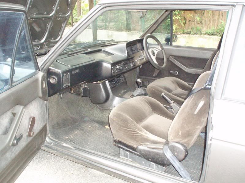

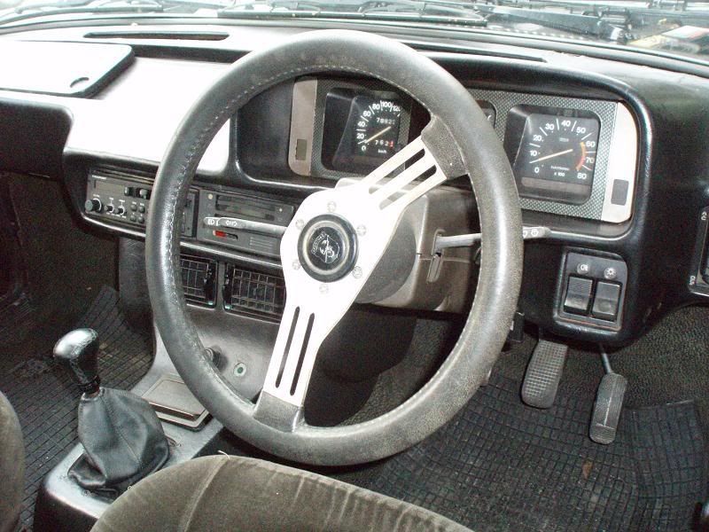

I agree,on the subject of restoration, this car will need some tlc to make it really sharp i think,but a light ongoin resto is fine,so,whats the parts availiblity like for the sport?, the car will get close inspection tomorrow hopefully and i may need a couple of items to take down with me,(i have a container booked for the house stuff) for example it seems the dash board has a crack/split in it,and the steering wheel is a bit tired, anyone out there with a hoard of sport parts?  Grin
