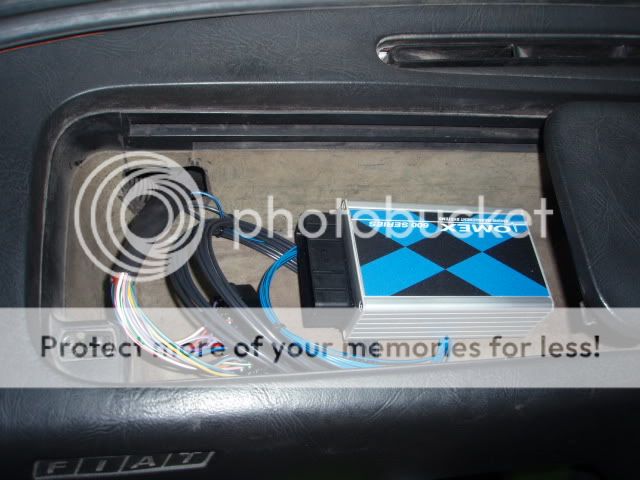

im fitting an omex 600 ECU/EFI, thats electronic ignition and electronic fuel injection with Throttle bodies, without distributor ill post a few extra photos below.
As i only get every other month at home the going is slow at the moment, but i hope to get 90% of the work competed before the end of November.
To date ive fitted the Trigger wheel and Crank positon sender to the front of the engine, Omex unit is in the dash and wired in, Coil unit is fitted onto the inner wing.

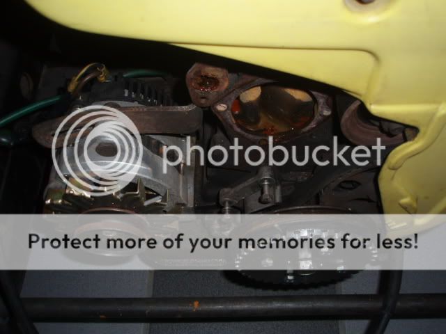

Trigger wheel on front of crank and the bracket i used for the CPS.
Omex 600 in glove box
Used this grommet to pull all wires through.
Trigger wheel and CPS fitted as per Omex instruction (google Omex and go to their www loads of info on line)
