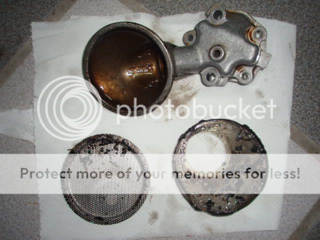

Nope, their is a spring in the pump and its a relief valve spring for the pump itself (page 131 GC Modifying and tuning Fiat/Lancia Engines).
And before refitting any old pump please please remove that gauze and check behind it, look what i found hiding behind mine?
keith m 131
Posts: 108
« Reply #14 on: October 24, 2012, 05:50:51 PM »
Hi Parrish,
Interesting find, Heh
Keith
