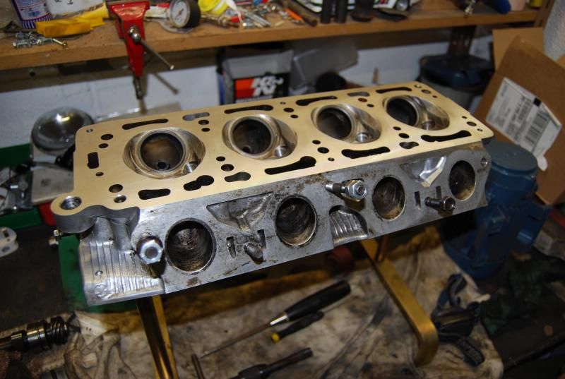

« Reply #5 on: March 04, 2014, 07:44:10 PM »
Good man Finnie thats a deffo thing to do as every head we did last year had some warpage thats 5 engines lol!
please post up what you are doing pics etc Grin

« Reply #9 on: March 12, 2014, 08:19:11 PM »
Ok all
A few pictures of the 2 litre engine - and other engine is a BMC getting new liners and pistons (for my boat)
[URL=http://s307.photobucket.com/user/finnie2007/media/engines003.jpg.html]
finnie
