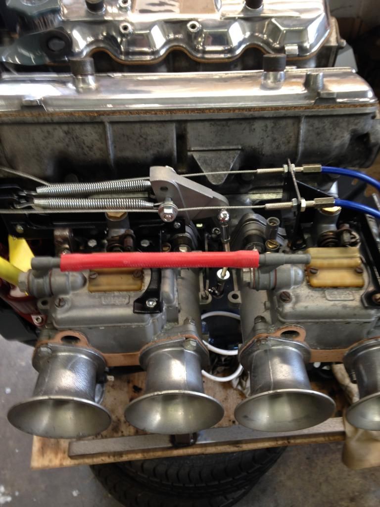

« Reply #31 on: May 09, 2014, 07:51:07 PM »
This is the new cable system not the best quality and think  ill reverse it so it pulls from the front

« Reply #32 on: May 11, 2014, 04:49:22 PM »
It's now reversed
But anybody ever fitted twin cable and how
Did you do it ? It's that little blue thing😄😄
« Reply #33 on: May 11, 2014, 06:42:26 PM »
From memory the block fits onto the top of the accelerator pedal. You'll probably have to cut the top of the pedal to get the block into place.

« Reply #38 on: May 21, 2014, 04:02:46 PM »
Last update - ready to go 10 mm leads and normal speedo cable altered to fit carb side 😄
« Reply #39 on: May 21, 2014, 08:56:02 PM »
Looks the biz lad hope all goes well Wink
